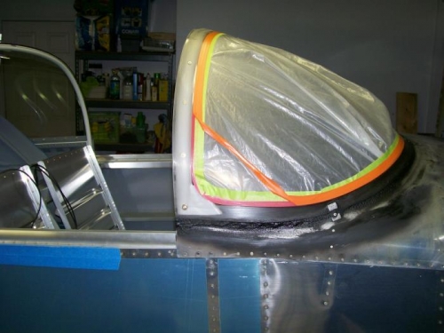

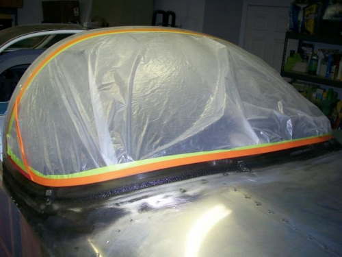

Brief Description:  Windscreen
Installed the windscreen. Over drilled the holes I had already drilled at the rollbar then countersunk the holes. Clecoed to the rollbar and taped each hole and added #6 screws. Added a few metal tabs with pop rivets around the front. Added two layers of colored electrical tape to the fairing line. Sanded the plexiglass and skin. Added a layer of epoxy with flox and some black dye.
I had used the tape in such a tight radius at the bottom corners that after a few hours the tape pulled loose. I will need to retape later.
