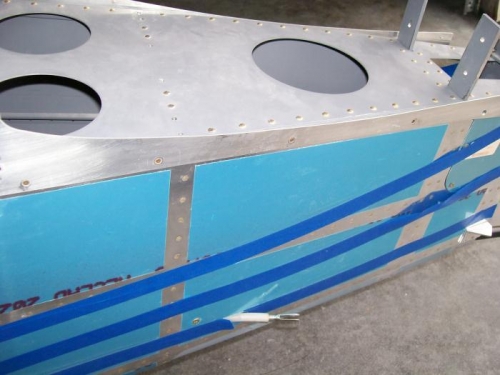

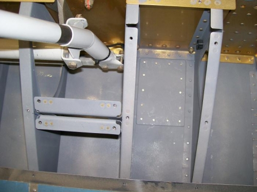

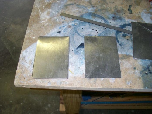

I riveted the lower fairing on instead of using screws. This needed to be done before paint. Also needed to rivet some antenna doublers. I had decided to use two antennas mounted to the belly so these were added to the bottom right behind the spar.
Emp. fairng riveted on
doublers cut, drilled and alodined
counter sunk primed and riveted
