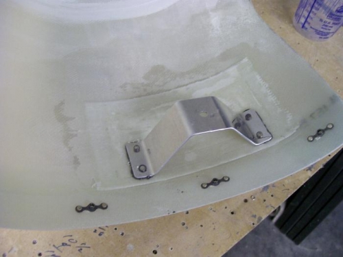

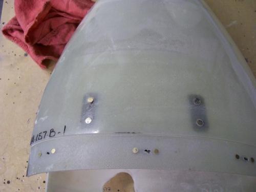

Not much time in the shop tonight. I checked my work from last night and redrilled the outboard brackets to the rear pant. Counter sunk the rivet holes. Mixed up a little Proseal and riveted the brackets in place using # 4 rivets. I will leave it over night to dry.
Look from the outside

Look from the inside
