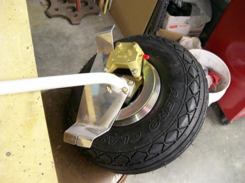

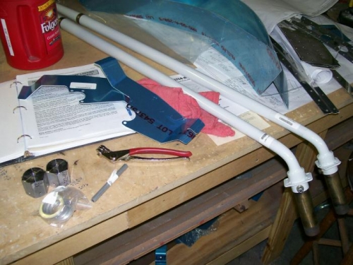

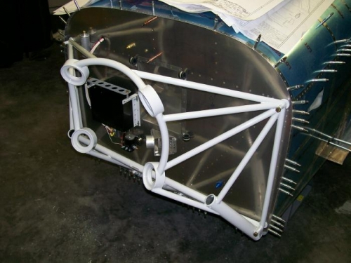

Brief Description:  Wheels, brakes & Engine mount
Alodined the canopy skins to get ready for paint. Mounted calipers, greased wheel bearings and bolted together with the wheel pant bracket. Drilled axle for the cotter pin. Moved to the engione mount. Ground reliefs for gear legs in the bottom skins. Drilled the mount in place.
