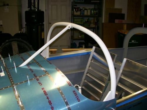

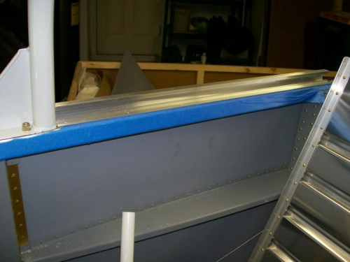

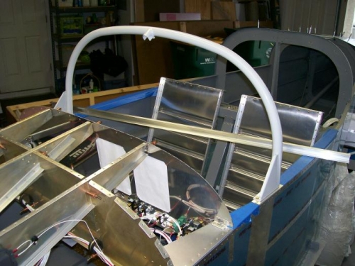

Brief Description:  Roll bar and canopy
Finished bolting the roll bar on. Cut and added the front roll bar support. This required clecoed on the front skin. I want to get the rear skin finished so I installed the rudder cable since it came with the finish kit. Tomorrow I will finish riveting the skin. I cut the canopy rails to length and drilled. I drilled and installed the C-661 bearing block in the canopy frame. I checked the shape of the rear bearing track and then drilled to the spacer. I will counter sink and rivet tomorrow.
