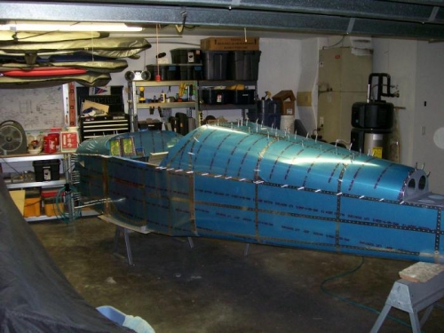

Date:  8-15-2012
Number of Hours:  2.50
Brief Description:  Top skins and F-710

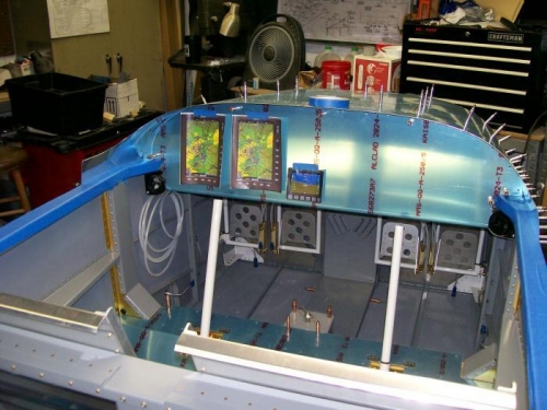

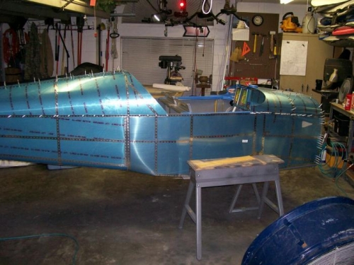

I had glued the NACA vents on last night. Pulled all the clamps off and installed the hoses to the eyeball vents. Finished de-blueing, deburring and dimpling the last top skin. Riveted on the rear bulk head I think is labeled F-710. Clecoed all the top skins on. It is time to start thinking about the panel layout so I taped on a couple of instruments.
