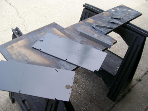

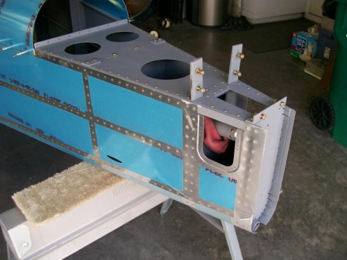

Brief Description:  Empennage and panel parts

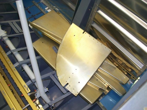

Finished up the empennage mounting with fabricating the rudder stops and riveting them on. Then acid etched a batch of parts. Some then got primed. Some then got painted some didn't. Adjusted the elevator pushrod after adding the rivets to the end pieces, I had ordered some from Van's as I had run out Riveted the rudder front spar attach plate to the front spar. Then gathered all the attach bolts and put them where needed. Riveted the air vent attach angles and screwed in the vents. Clecoed the panel and all the ribs. Started riveting a few of the parts. I will probably leave the center sub-panel clecoed so it can be removed later. It will be necessary to cut the center sub-panel for the radio stack and removed will be much easier.
