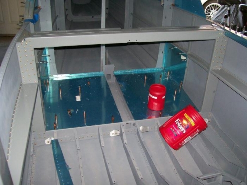

Installed all of the platenuts in the F-906 bulkhead that hold the baggage bulkhead. Drilled and added the platenuts that hold the covers to the F-728 center vertical rib. Clecoed in the baggage side skins then the floors. Fabricated the seat hinges to the rear seat floors then clecoed them in. Clecoed the forward seat skins then fabricated the tunnel cover. I could be riveting in the rear covers but I haven't finished riveting the bottom skin of the fuselage so these would cover them up. I will need to remove all of these covers to finish the riveting. I will need to find some help and get this done soon.
Lots of cabin floors installed today
Baggage floors going in

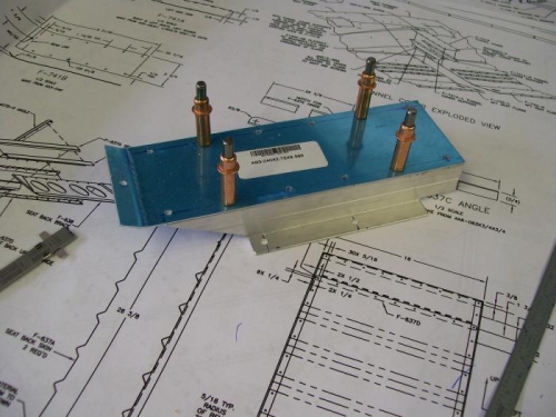

Center control tube cover
