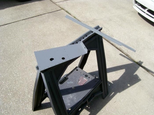

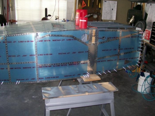

Brief Description:  Forward fuselaqe assembly
Finished up F-9101 (called gear attach but it is only a gear attachment plate for the A models.) and F-713 stiffener on the right side. Alodined, primed and painted. Then started riveting the left side. The left side is complete with all that can be done solo. I am going to use Proseal to seal up the firewall to skin areas so I didn't rivet the last 5 or 6 rivets toward the firewall. This will allow me to peel the skin back and brush in some Proseal before riveting. I inserted the floor stiffeners and riveted the inside two. The outside two only get attached to the bottom skin so they will weit.
