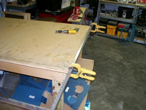

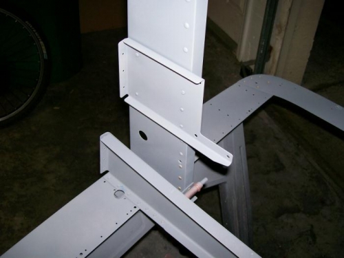

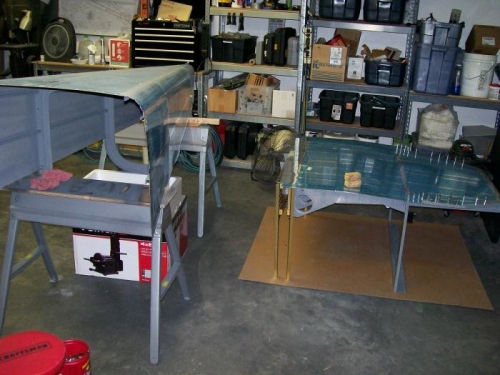

Finished dimpling the right side skin and put it in the spare bedroom. Pulled the aft and center sections apart and pulled the longerons out. Deburred and dimpled the aft section and F-706 bulkhead. Pulled out the servo mount I had ordered a few weeks ago and riveted to the F-706 bulkhead bottom rib. Touched up primer on all these parts so I can rivet tomorrow. At this point the instructions are not specific about what you do when. Most people don't do this rib until the fuselage is together. I don't see a reason not to do it now while I can reach it. I will rivet it tomorrow. Started deburring and countersinking the longerons. Still a little left to do tomorrow. They also will need to be alodined and primed along with the side skins. We have had a Tropical storm Debby in the area for about five days worth of rain so that I can't paint. I will get it soon.
Aft section and center section apart
Pitch servo mount installed
Longeron clamped to the table for counter sinking
