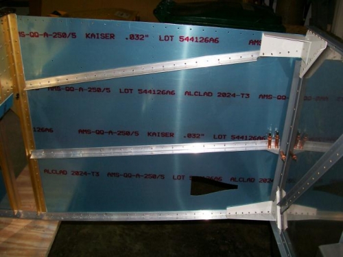

Shaped, twisted and drilled the F-713 Aux. longerons then clecoed into place. Fabricated the F-719-B attach angles then drilled the F-719 stiffeners in assembly. Mounted and then drilled the attach angles. Short night.
The top angle is the F-713 Aux. longeron the middle one is the stiffener
