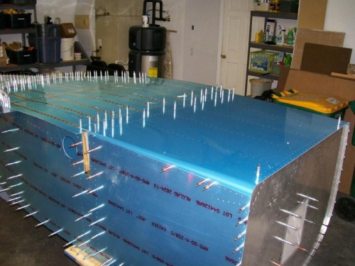

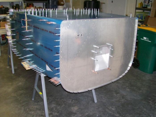

Date:  6-10-2012
Number of Hours:  4.00
Brief Description:  Forward section
Finished drilling the right longeron then match drilled the rest of the fuselage. Drilled the forward longerons and installed the firewall. Installed the forward lower skin and set the firewall depth. Drilled the firewall flange on both sides. Looking more like an airplane. It is ashame it will all have to come back apart to dimple and prime.
