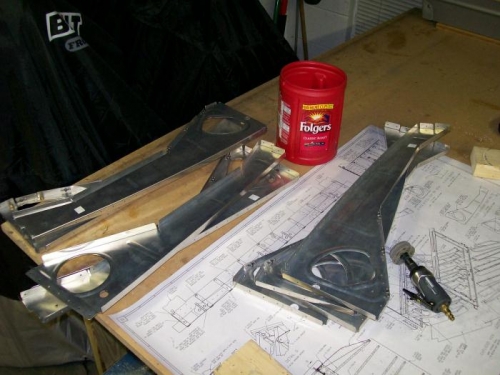

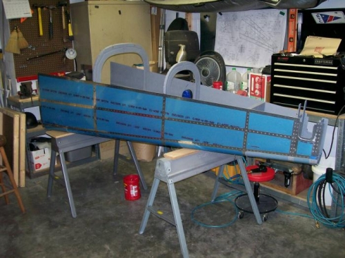

Finished all the riveting that I can without help on the tail section so I set it to the side. Moved on to the center section. This means starting with the seat ribs. Had to cut the holes larger for control clearance. Also the two inboard ribs get the tops cut out and a bolt in filler piece installed. Added nut plates to all the ribs and started deburring. I usually wait to deburr after assembly but these are sharp and I am trying to prevent too mush boring stuff at once later when I disassemble for primer.
Only a bottom row left to rivet but I need help.
