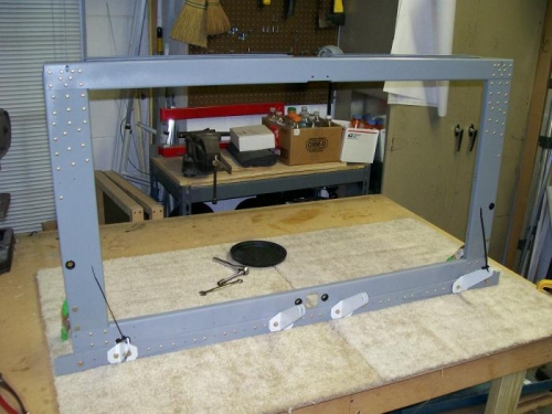

Date:  5-22-2012
Number of Hours:  3.00

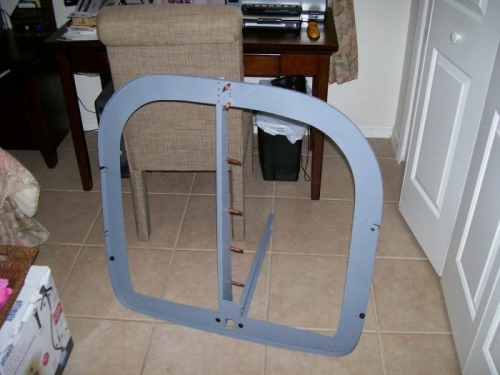

Brief Description:  Finished F-905 and F-906 bulkheads
Paint and primer were dry so I started assembly and riveting. F-905 first. Riveted the corners together and then bolted the seatbelt brackets to the rear spar. The top brace got the seat back brace angles riveted on. Then I worked on F-906. All the bellcrank rib and riser were riveted to the bottom span first along with the stiffeners then the side bulkhead pieces. Both these now in storage in the middle bedroom.
