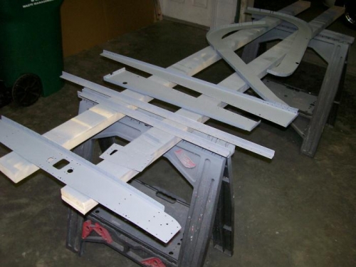

Brief Description:  F-905 and F-906
Picked up another case of Sherwin-Williams eching primer and a couple of cans of grey paint. Finished priming the back side of all of F-905 parts and then painted. While the paint is drying I started on the F-906 bulkhead. Found all the parts and then fabricated F-908-B, F-929-B and F-930 angles. Drilled the reinforcement angles in assembly and the rest of the parts I match drilled. Pulled it all back apart and one at a time I deburred, dimpled as necessary and added grommet holes where shown. Layed parts flat on the table and fluted to get them flat. Cleaned it all with MEK and then primed. I had forgot to take a picture but after assembly and riveting I will take more.
F-905 parts painted and ready for riveting
F-906 parts primed and ready fror riveting
