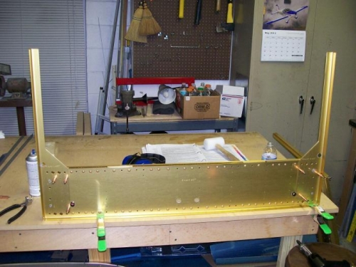

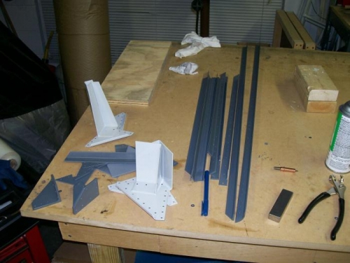

Washed all aluminum parts with water and Dawn. Cleaned with MEK then primed. For some reason I have decided to paint these parts with gloss gray paint. They are now drying for riveting later. While waiting on the paint to dry I moved on to the F904 biulkhead. I drilled holes for wiring grommets. Clecoed on the sides then drilled the spacer bars. I then riveted these bars and am now ready to rivet the sides on.

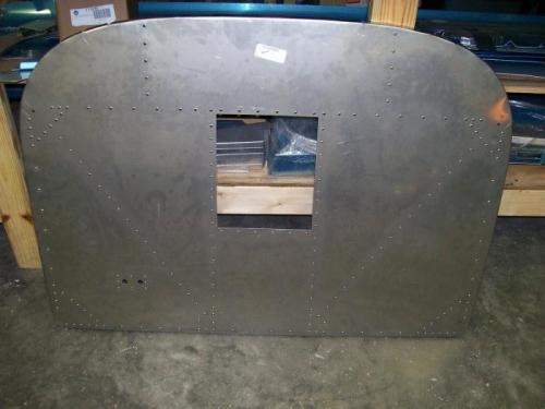

Firewall is dimpled and ready for riveting stiffeners
All firewall parts are cleaned, primed and painted
F904 bulkhead drilled for grommets & sides clecoed on
