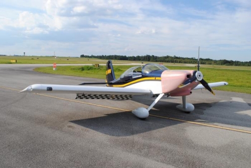

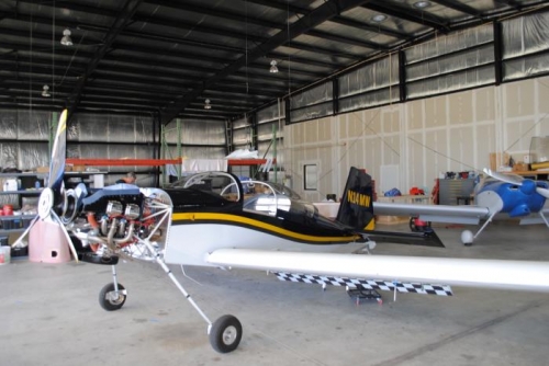

Date:  10-13-2013
Number of Hours:  9.15
Brief Description:  Flaps, wheel pants & cowl
Installed the required builders label, flaps, cotter pins in the rudder cables, wheel pants, fairings. Safety wired the alternator and prop. Finished the baffle material on the air cleaner and cowl inlets. Mounted the cowl and taxi for a few minutes. Starting to look like an airplane!
