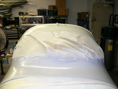

Date:  9-17-2013
Number of Hours:  2.50
Brief Description:  Cowl and fairing
Sanded the fairing again and then primed. Moved the palne back in the garage and started on the cowl. Sanded the inlet ramps and then added micro. I am using a small cut in the center top of the cowl to access the top hinge pins. I am using a trapazoid shaped piece of aluminum as the filler piece. I added a few layers of glass below this so that it will help hold the cowl down when installed.
