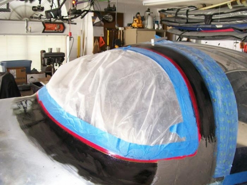

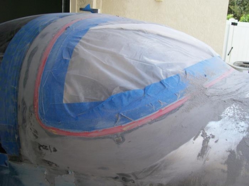

Got an early start this morning as I had a 10 AM appointment. I wanted to get a layer of micro on the front section. This meant an hour of sanding first than the micro. I used fast hardener so that I could sand it thesame day.
Returned after lunch to get another start. Sanded the new micro and the micro accross the top. The top layer of tape was getting ratty so I changed it after sanding. Fairing is looking great.
I marked the rear of the top fairing for a final trim and then used the pnuematic cut off and got it trimmed. Then sanded.
Bottom corners needed more micro so I added a layer and then used some thinned epoxy for the rest.
