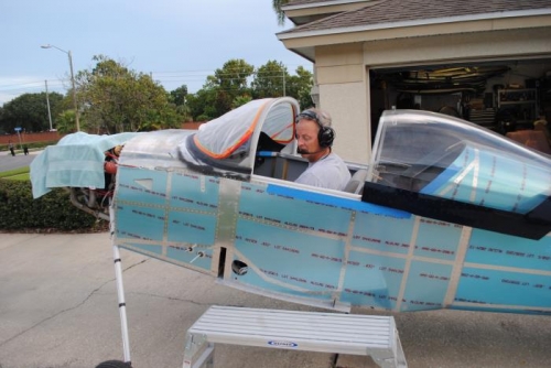

Brief Description:  Lots of small stuff

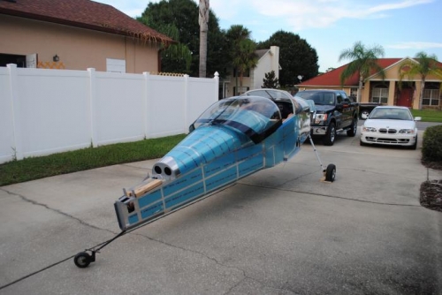

Cut, drilled, bent and alodined an antenna doubler for the ADS=B antenna. Alan showed up to help with riveting the last few rivets. Finished up a few on the front skin that were hard to get to and then dimpled and riveted the new doubler. Installed the air cleaner and heater scat tubing. Connected the oil heat damper cable. Installed the cabin heat cable. Spent some time organizing the shop. Cleaned up the dining room table where I had been doing avionics harness work since I am finished with all that work. Finished sanded the front of the canopy so that the front edge would line up with a good gap. Finish fit the latch for a good fit and added the spring. Mechanically the plane is ready to take to the airport. Now it is just about fiberglass work. Tomorrow I will start the windscreen fairing.
