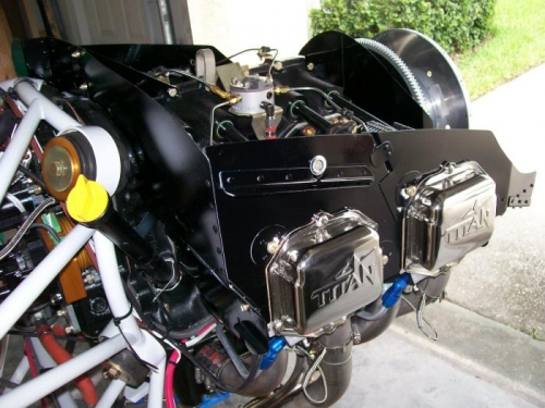

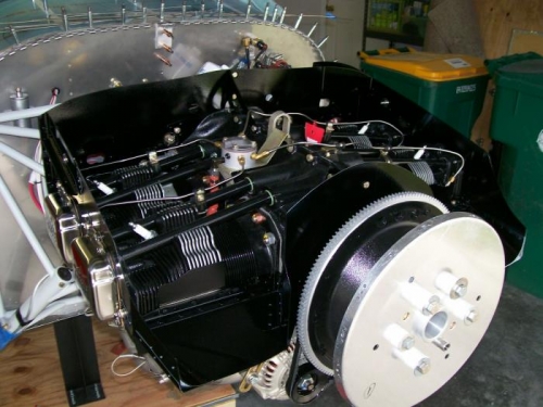

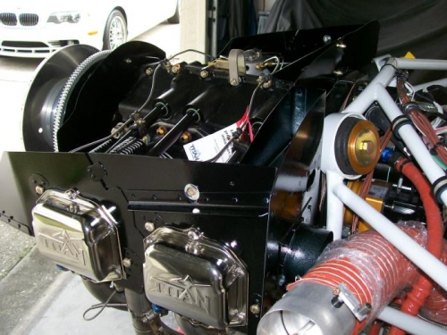

Finished all last baffle trimming. Primed and painted. While waiting for them to dry I epoxied and riveted he cowl side hinges. When the baffles were dry I installed them for the last time. Boy what a relief. All screws in place. They came out looking very nice and they fit well. I will caulk later. I ran the spark plug wires and connected the oil cooler scat tube with the damper installed. I tightened the exhaust since I figure it is on for good now.
