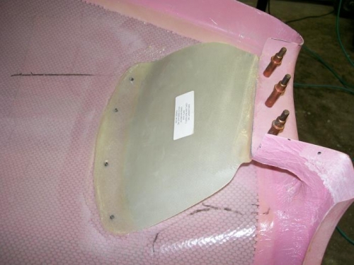

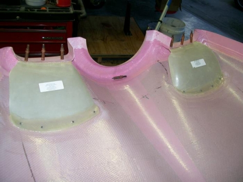

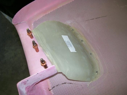

Brief Description:  Baffles
Worked on the front baffles. I had them trimmed for all areas except the front where they touch the inlet ramps. Held the baffles in the top cowl while upside down and on the workbench. Got them close and then mounted everything on the plane and final trimmed. Snaded the inside of the cowl where the ramps touch and drilled them in place. Used epoxy with stuff to thicken and epoxyed in place. I put the cowl top back in place to let it dry to the right shape.
