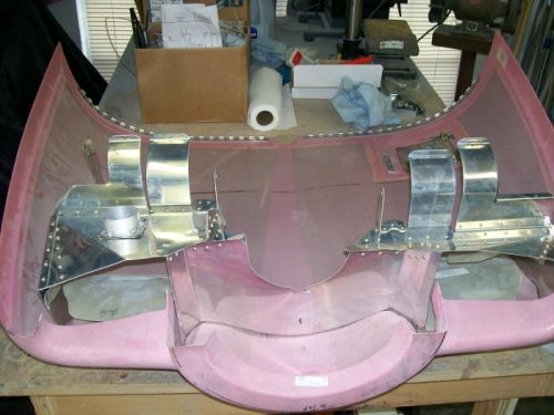

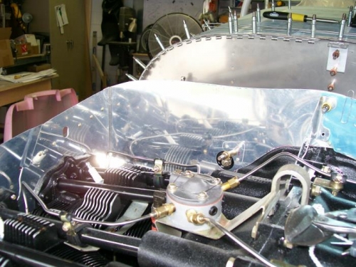

Brief Description:  Baffles
Spent all day on the baffles. Finished trimming the top for clearence to the cowl then remounted them and double checked all clearences. Final drilled all parts to get ready for paint. Trimmed front ramps for clearence to the inlets. Alodined all parts and then assembled. Including the air inlet for the heater, oil cooler hose connection and block off for the original heater scat hose. Finally layed the forward baffles in the top cowl to see how the inlet ramps will line up..
