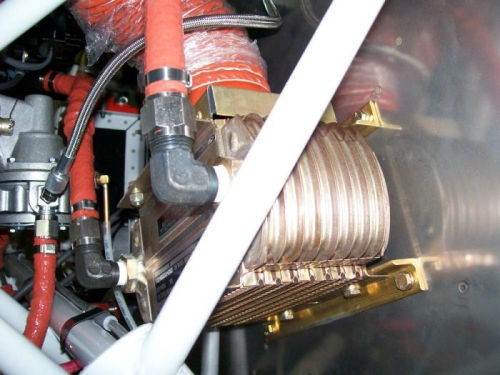

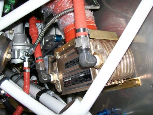

Brief Description:  Oil cooler & harness

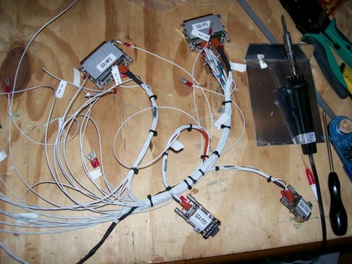

Removed the oil cooler and alodined the aluminum brackets and hose connection. The bolts I had used were a little too long so I used the correct bolts and remounted the cooler. I also sealed the shroud with black RTV. Installed the new oil hoses that Tom at Flightline made for me. Perfect size and length. Also used new steel fittings I had ordered. Moved to the living room and worked on the harness. Soldered up the Can Bus and configured to the right shape.
