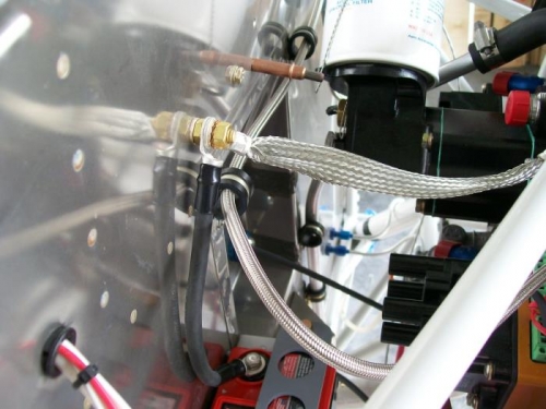

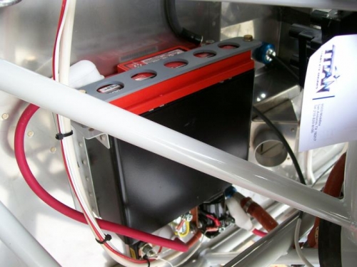

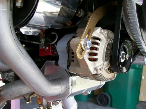

Brief Description:  Engine stuff
I received a few deliveries the last couple of days. The cowl and baffles haven't been much fun so I decided to have fun today. I dropped the exhaust enough to add gaskets. Installed the battery and starter cables. Used adel clamps to support. Installed new fuel hoses and Red Cube. Adel clamped to the forward sump. I used DB connector pins with heat shrink to connect wire to the existing short wire. Extended the other sensor wires while I was crimping. Install alternator and belt. Spent some more time on the baffles by trimming the rear baffle pieces. Good day today.
