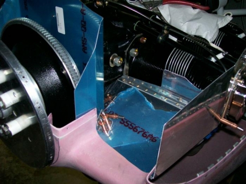

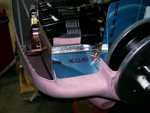

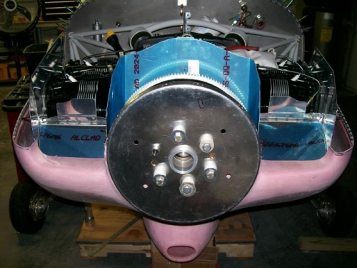

Brief Description:  Baffles
More fun baffle work. Riveted the right side ramp together, then a little more trimming. Added he support angles and added the front center baffle. I had trouble understanding one of the steps and after about 15 minutes later I realized that there were flanges that were supposed to be bent in the lower part of the front side baffles. I trimmed this area off. Not much of a problem as I can use .032 angle to make a flange. Baffles are a lot of work but coming out nicely. I also received my battery today.
