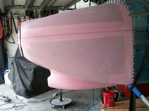

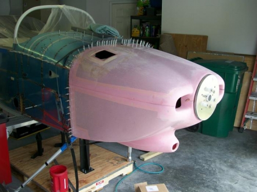

Today was about the cowl. I knew that i needed the lower cowl fit in order to work on the baffle inlet ramps. So enlarged the gear leg cutout and started fitting. On then off and over again. Must have had it off fifty times today. Got the bottom trimmed first and this is very important as this holds the front of the cowl in position. Then the fuse sides and then the cowl sides. All done sanding so I drilled the hinge rivets for the side and then the lower cowl sides. Decided to epoxy and rivet the hinges I had complete. Last picture has rivets instead of clecos. Still have the fuse sides and the upper cowl to complete but I got a lot done today. Looks good.
