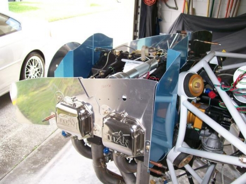

Brief Description:  Firewall forward stuff
Started the day with finishing the exhaust. I decided the angle i wanted and finished up the hangers. Worked on engine mounting bolts by adding washers and cotter pins. Installed the exhaust heater. Moved the servo inlet from the starboard side to the port side. Reinstalled the crankcase breather tube. Removed the servo and extended the mounting studs and reinstalled the servo and torqued. Started on the baffles. These fit much better than expected. Everyone complains about fit. I think maybe this is a newer version as they fit easily with little trimming. Still have plenty to do on the baffles but I think I now need to remove them and fit the lower cowl first.
