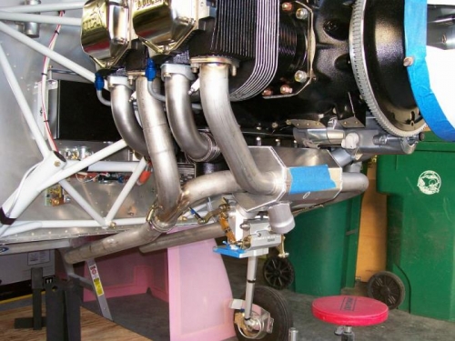

Brief Description:  cables
Measured and aligned the cables. Decided to pick a completely different spot than what Van's recommends. Drilled the firewall and ran the cables through new firewall eyeballpass throughs. Finished the cables and spent time thinking about Red Cube location and fuel hose routing. Gave up and then worked a while on the exhaust. I think the exhaust needs to be in place to determine the other routing.
