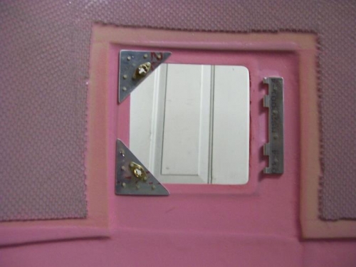

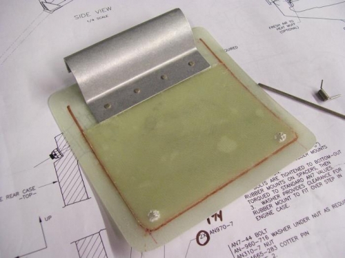

Date:  6-16-2013
Number of Hours:  4.00
Brief Description:  oil door
sanded the micro filler off the oil door. Spent some time deciding how i wanted to fasten the door. Decided I really like the Dzus fasteners but not the ones provided by Van's. I used the sockets provided and built some mounts. I then added 5 layer of glass for reinfordcement for the door. Now I need to order a flush stainless Dzus from ACS.
