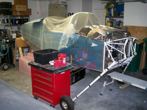

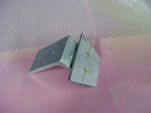

Moved fuse in the garage to make room for engine mounting. Worked on a mount to hold top hinge pins in the center instead of using the oil door for access. Shaped an angle piece to mount on the firewall drilled to hold the hinge pins. Cut a piece to screw to this angle that will hold the cowl down and the pins into the angle.
