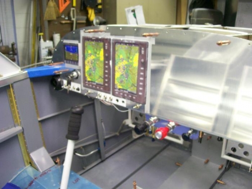

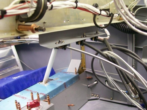

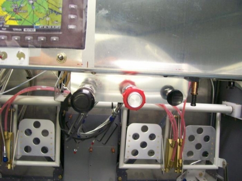

Brief Description:  Engine Controls
Spent the evening working on engine controls. Picked a spot where I wanted the knobs and decided spacing. I used 2.75" spacing between knobs and have the throttle located directly middle of panel. Cut the mounting bracket to size and rounded the corners. Drilled for cables. Drilled bracket for mounting and added platenuts. Inserted cables and screwed to panel. This allowed me to mark the secondary bracket for proper adel clamp locations to hold the cables. Drilled the secondary bracket and added adel clamps. Mounted the entire assembly.
