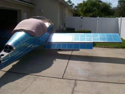

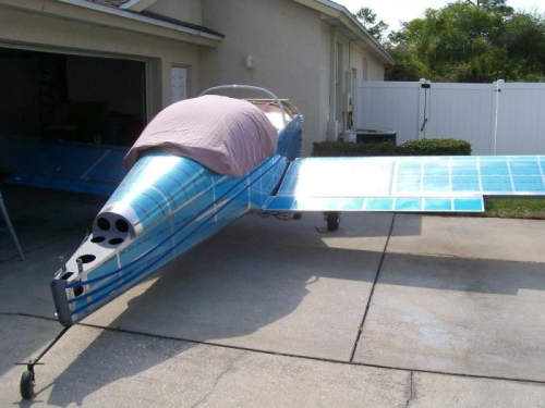

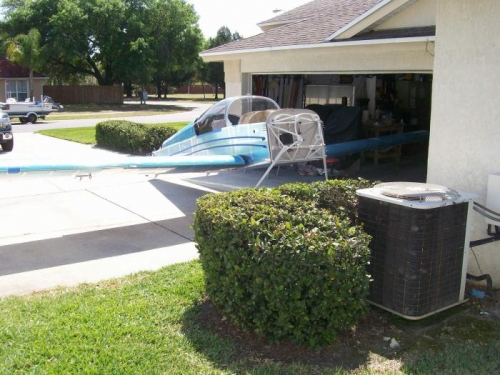

Brief Description:  Wing initial fit
Today was about fitting the wings so I can then get them painted. Started about 8am and moved the fuse into the driveway. Set up the tali on a saw horse to get the fuse level. Installed he right wing when Alan showed up with Michael right behind him. Shortened fuel lines as needed and thew wings went in easily. Followed by the Left wing. Set the sweep and then the incindence. Drilled the rear spar. Things went well and easy. Worked on the wing gap fairing. Drilled, trimmed and then re-drilled to #8. Debured and dimpled. Then I installed the flaps and fit the pushrods. This required drilling and trimming the pushrod hole. Hooked up a 12v power supply and played with the flaps for a while. Removed the wings and put everything back away. I will move the fuse to storage next week to make room for painting the wings.
