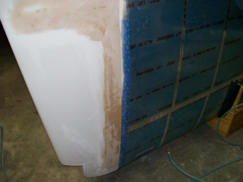

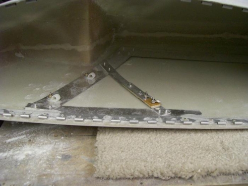

Forgot to mention the Archer Nav antenna riveted under the hinge on the right side tip. I added a layer of epoxy with micro to fair out the fiberglass above the rivets. Still alot of sanding to do to get the micro flat. I have been having problems getting the Left side tip on since I added the ribs. It seems I have the rib too far back and it has spread the tail of the tip. I will need to come up with a solution for that.
Archer Nav antenna on the lower right side
