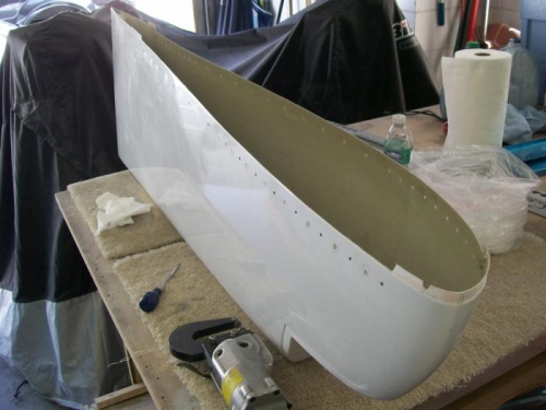

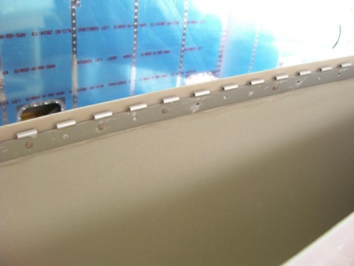

More wing work. Second side hinges complete.
First side hinges riveted
Flange ccut off tip and used for a spacer on the wing side hinge
Fit checked after the hinge is riveted to the wing before the other half is riveted to the tip
