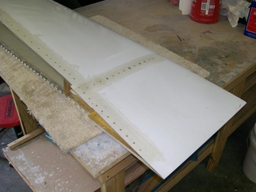

Brief Description:  Wing tips
Today was about tip ribs. Drilled ribs and checked fit. Removed, trimmed ribs to fit with th hinges, epoxied into place with only clecoes. Once the epoxy was mostly dry I riveted the ribs. Sanded the rivet lines and added a layer of epoxy and fiberglass so rivets won't show through the paint. I got both tips done with riveting and one side each with fiberglass.
Finished riveting all the parts to the tip so added strips of fiberglass over the rivets

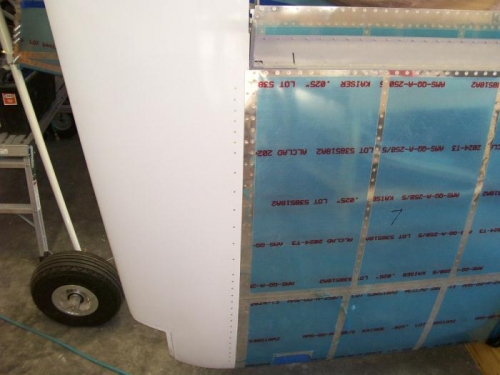

Hinges rivete and checking fit
