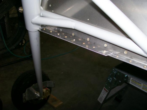

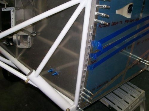

Brief Description:  Getting fuse ready for paint
Installed hinge at firewall sides for future cowl attach. These needed to be riveted so I can paint the fuselage. I have always heard that RV's break the bottom hinge due to vibration. I had seen a plate used with plate nuts and screws and was told this worked well so I attached plates to be drilled later.
