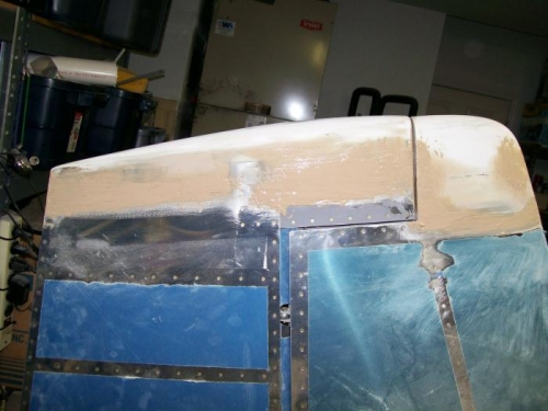

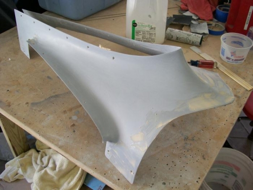

Brief Description:  Fiberglass parts
More filling, sanding and priming. I have now painted and cleared the wheel pants and they came out nice. I got the clear a little dry which gives it some ornage peel. This can be sanded and polished out if I decide to later.Filled and sanded and then primed the emp fairing for a final time. It is now ready for color and clear but I had not bought the blue color needed yet. I am still waivering between royal and navy blue. I have the rudder temp. mounted so I connected the cables and started the fiberglass work. I am on the third coat after some glass strips and a lot of sanding. I riveted the platenuts on the wheel pant brackets. Put first layers of glass on the horizontal tips.
