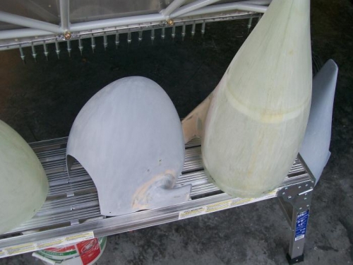

Brief Description:  fiberglass

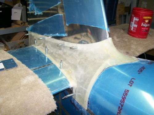

Spent more time on the wheel pants and leg fairings. I sanded again and added filler one more time. I think after one more sanding of the new spots, they will be ready for final primer. I may shot base/ clear next week on a few parts. Spent more time trimming the empennage fairing and now have it drilled and clecoed in place. This piece fits very well but will need to be fit at the top around the vertical stab. I may split the front end to elp close the gap rather than just fillling. It fits so well at the fuselage that I am going to use fewer screws than shown on the plans.
