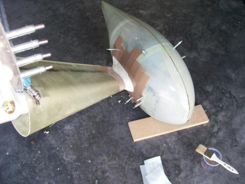

Date:  11-23-2012
Number of Hours:  4.00
Brief Description:  Intersection fairings
Started the lower intersection fairings. I taped the wheel pants and leg fairings so the resin won't stick. Then molded clay into shape and covered with fiberglass and resin. Nexst day I added another layer of glass. After dry I cut them down the middle to remove.
