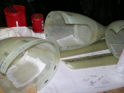

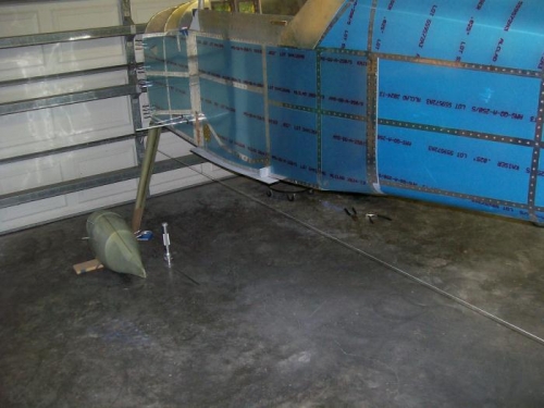

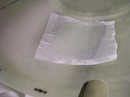

Brief Description:  Wheel pants and fairings
Reinforced inboard bracket side of wheel pants and then added a aluminum strip of reinforcement to the top fairing attachment. Installed pants and fairings and lined up the fairings. Added packing tape to the wheel pant and fairing so I can start the intersection fairings.
