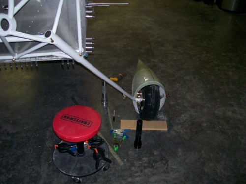

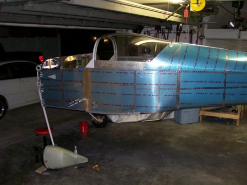

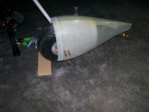

Brief Description:  Wheel pants
Trimmed the fron pant to correctly fit the rear pant. Sanded for a good fit. Bolted the outer bracket to the axle nut then leveled the plane. Drilled and riveted the platenuts. Trimmed for the axle and fit the pant to the wheel. Drilled to the outer bracket after lining up with the center line of the plane.
