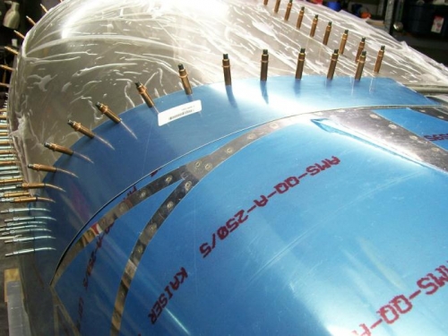

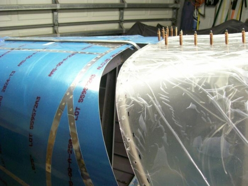

Brief Description:  Canopy rear skirts
Started on the rear skirts. Trimmed the excess plexi after the rear bow. Pre-curved the skirt then marked the canopy about a 1/2" infront of the bow. Layed the skirt on and marked the top end for trim. Drilled and clecoed starting at the top working my way down keeping the skin pulled tight. Marked the front edge for trim and removed and trimmed. Re-installed and marked the bottom and rear edge for trim. Removed and trimmed. Re-installed and drilled the bottom of he rear skirt to the side skirts. Started on the right side and got the canopy trimmed and started forming the skirt. I am amazed at how well this turned out. Very nice and snug skirt. Much easier than I expected.
