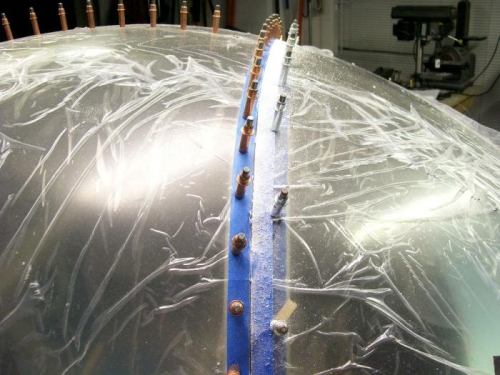

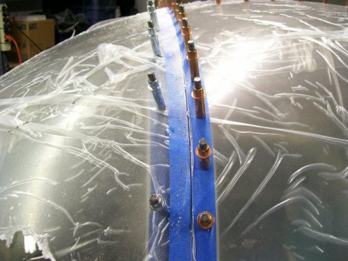

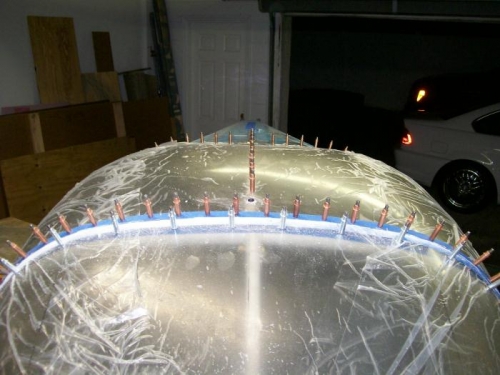

I am about ready to start the last stage of the canopy, the rear skirts. This requires that everything else is finished and aligned. Figured I better go back and fit the windscreen. A little more trimming and a lot of sanding. Finally found what I figured was the best spot so I drilled the top edge to the rollbar with a little extra overhang at thee rollbar so i can trim later to match the canopy front edge. While the windscreen was clecoed on I used the sanding bar and hand sanded. Checjked the gap and sanded some more. This took a while but the finished product is perfection. Not even enough gap to slide the steel ruler. I removed it and finish sanded the edges then moved it to the middle bedroom. (Storage). I need to remover the canopy again to do a little trimming before starting the rear skirts.
