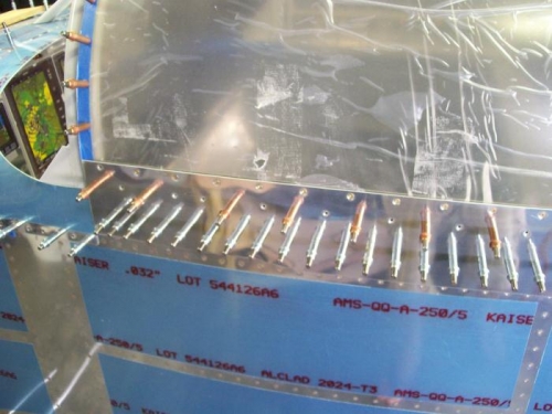

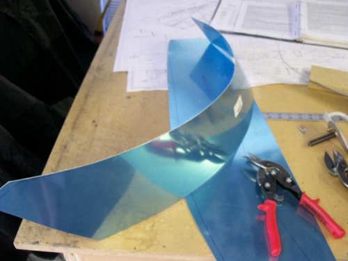

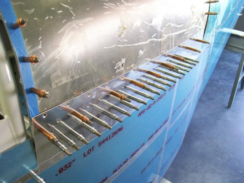

Spent some time on the windscreen and then moved to the canopy side skirts. Trimmed the leading bottom edge of the side skirts to clear the rails when opening. Drilled the skirt to the bottom edge of the plexi then dimpled everything and countersunk the canopy. Bolted and clecoed it all together and put Marsha in the cockpit and drilled the bottom of the side skirts. I am very happy with how the canopy fit is coming. At this point it is very well adjusted and it rolls very easy and smooth. Cut out one of the rear skirts and started shaping. It looks like the fit of the rear skirts will come out well. More work on that later.
