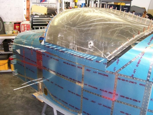

Brief Description:  Canopy

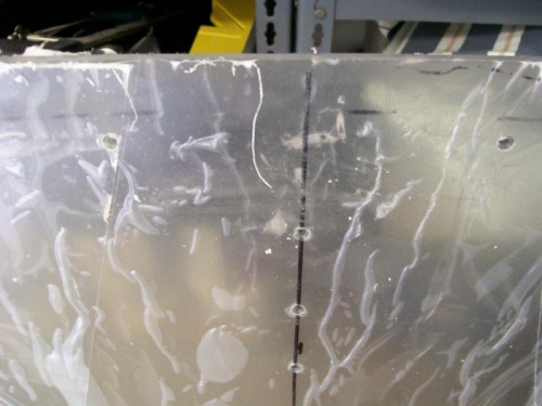

Spent some time getting the canopy height correct with adjusting the height of the canopy front bow at the roller. I had previously cut the tubes and now I have added some of the tube back. Pulled the canopy off and counter sunk the rivet holes and then drilled them out to 5/32 " with a plexi bit. Drilled the holes in the frame to #30. Started on the side skirts. Drilled the lightning holes and deburred. Drilled the side skins and then mounted and drilled the skins to the canopy. Things came out very well and tight. I still need to get the C-791 drilled but I need Marsha inside the plane applying pressure. Tomorrow.
