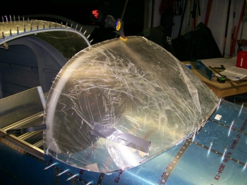

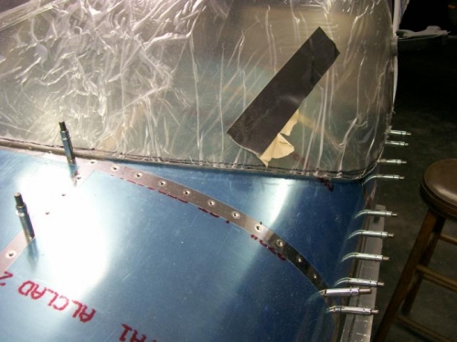

Brief Description:  Canopy and Windscreen
I am about to start the canopy side skirts but figured I better get the canopy height set first. The way to get the height correct is to set the windscreen height first and then space the canopy frame height to match. So I started trimming the windscreen. Couple of trims later and I figured I better get the front of the canopy straight and trimmed back the correct length. I had left it a little long thinking I could use the sander to get it straight but that doesn't work. So I trimmed it straight and then sanded smooth. The canopy looks great. Then I kept trimming the windscreen. Getting close but will need to trim at least one more time and then cut the back straight.
