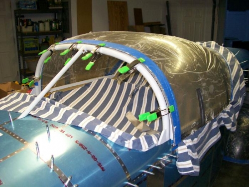

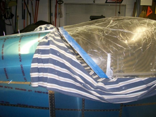

While the frame was in the canopy I marked for the "Big Cut". I cut the rear to the proper length and then made the big cut. Tried it on the fuse and then put back together and marked the sides for the proper length. Cut the sides and then started sanding and smoothing.
I made the big cut and then tried fit

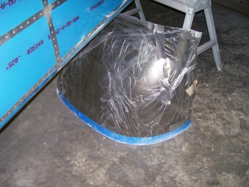

Windscreen cut and stored in the floor
