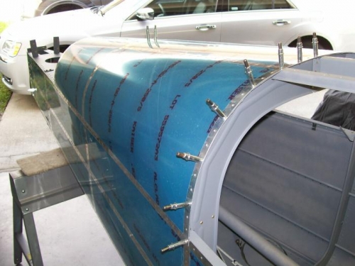

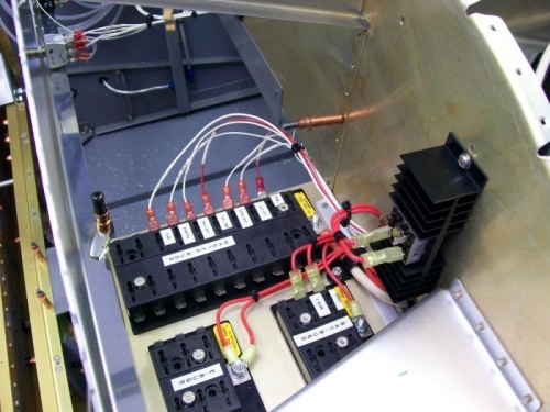

I received the wire for the LED strobes so I ran the last wire to the rear of the fuse. Time to rivet the rear skin. I alodined the last three skins, straightened the bulkhead flanges so the skins would lie straight. As I was clecoing he skin on I remembered I was also waiting on the rudder cables before i can rivet the skin. I decided to go ahead and rivet one side and leave the other open for access.

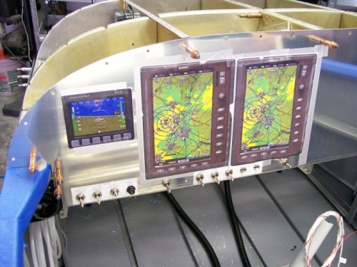

Installed all the toggle switches and clecoed the panel back in to start the wiring. Started running all the power feeders for the switches.
