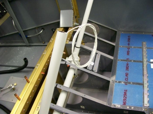

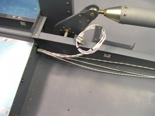

Brief Description:  Electrical
Ran trim wire into pilot stick. Soldered a d-sub 9 pin connector onto the pitch trim servo wire. Ran conduit in the forward center section to get wiring up the firewall. Screwed clapms to the firewall recess and ribs to hold the conduit then ran the wire from the aft end through the conduit.
